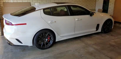

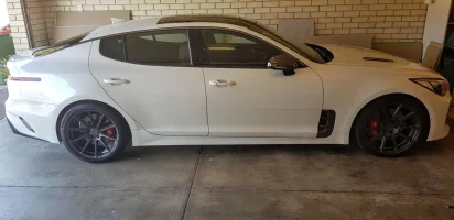

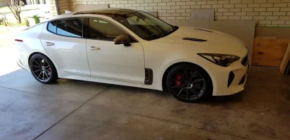

Installed the Kings, rears were very easy and the fronts weren't 2 bad except some of the ball joints were very hard to separate and one side I couldn't get it out but still managed to get the strut out.
Also had some koya custom 19inch rims I put on with sport contact 6's
Rear 10.5 +48 offset 295 30 r19
front 8.5 + 34 offset 245 30 r19
AAlso a big difference in weight at least a few kg each wheel lighter
Measuring from the center caps to fender
Rear 388 mm to 367mm
Front 388 to 365mm
I am not after a huge drop but I think It may drop a bit more as it settles and still need to get a alignment. I wouldn't mind the front dropping a bit more as my tires are 9mm smaller than the stock diameter and don't feel the wheel well as much.
It also rides and feels great not to firm at all and less body roll as the kings are a progressive rate design in the rears.

Looks nice, keep us posted on the settling in & how it rides......:thumbup:

Goof stuff Jesse, gives us a good idea of the lowering and what 10 spoked wheels look like. I'm tempted to go 15 spoke in black, I umed and arrd on which spring to go, I'm expecting a delivery of Eibach springs either today or tomorrow.
That looks really good. Got any shots from behind to show off the new stance?
