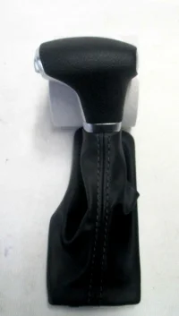

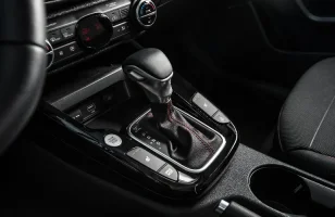

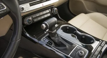

Anyone know if the Kia Telluride or Kia Soul shifter will fit a GT1? Love the look of the GT2 shifter but it’s electric, not mechanical so I don’t think you can swap them. I think the Telluride and Souls are mechanical so maybe it’ll work?
Not digging the GT1 shifter I have, looks cheap IMO.

It looks like it might.
I’ve swapped shifters on my Audi’s and it’s a pretty simple job. Had to reuse the leather boot as that usually is a different size.
You might just have to bite the bullet and order one to check fitment.
These look so much better!
From the pictures it looks do able. And a lot better, but until you take the river boot off each you won't know. Didn't somebody in here but a telluride? Maybe they can take a quick peek

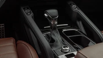

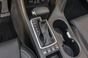

I did come across the 2016-2018 Kia Sportage shifter and from the pictures it looks like it may work. I still like the Telluride shifter look the best, but this Sportage one is still better than my GT1. eBay has them for about $30-$40 depending on if you get the boot or not.
