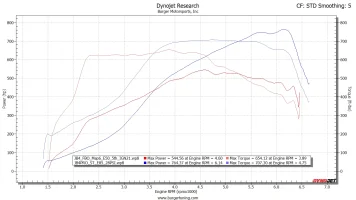

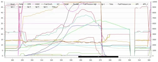

See attached log and dyno
Thanks! Around 17 degrees if I am right at 28 Psi (1,9 Bar). Seems that it can handle some timing if the studs is changed.
Even more impressed is with FBO if I assume that is has stock Turbos! A great "under the curve" torque, perfekt for a daily driver.
