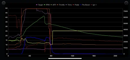

Was wondering if someone could take a look at my logs I got this morning? It would be very appreciated! I would like to start messing with the map 6 but honestly have no idea what would be best! These logs I got are in map 3 and I have one from 20 to around 60 and the other from 50 to around 80

For logs ideally 40-90mph, on a safe private track.
From what I can see generally looks OK. You didn't list the fuel and mods.
It's unlikely you'd come up with a map6 that works "better" than one of our preset maps. Map6 is usually used for special needs situations like reducing top end boost for elevation, etc. Using map6 requires the ability to monitor/evaluate logs/data in real time so not a great idea if you're not experienced with that.

Okay Thank You I am running 93 right now, I have a K&N Intake, Muffler and Resonator Delete, with a big mouth lit kit and 285/35r/19 Rear, 255/40r/19 Front
How much power do you think i should be getting on map 3? and map 4?
Map2 for 93 octane, map3 for E30+...
Around 420whp on map2 and 440whp on map3 w/ E30 I'd guess.
