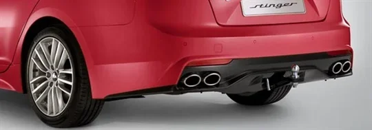

Bought my stinger from carvana. Car showed up like this with modded cat-back exhaust but it seems to be for a different model or someone cheaped out. The exhaust drone is incredibly unbearable. It says magnaflow on it as well. Any ideas of what I should do? Carvana won’t help me in anyway.

I would put it back to original
Buy the genuine Kia Bi Modal Kit which should be available over there
Bimodal Exhaust System​
Stinger’s bimodal exhaust combines premium hardware with intelligent electronics. Stainless steel construction, mandrel bends and protective powder coating form the rear muffler replacement system. Seamlessly integrating into the engine management system allows intelligent control of the actuated exhaust valve, transforming the Stinger from conservative saloon to howling sports sedan in a split second.
What if I were to get exhaust tips that extend out of the rear housing. Should that help the sound escape a bit better? It just sucks that I dont have four exhaust tips to actually make it look nice. I spent so much on the car already, I really can’t drop a grand on reverting the exhaust back to original
all you need to do is extend the muffler's pipes to reach well inside the fake tips, or get aftermarket tips and attach to muffler exit pipes. it'll take care of the drone.
you could also find someone local with a stock exhaust they can get rid of if you don't like how it sounds.
Yeah thats a cheap DIY muffler job. I'd start searching for a used oem exhaust and see if you can scoop one up cheap. You could try posting a wanted ad in the classifieds here, Im sure another member would give you a good deal if they have one laying around.
