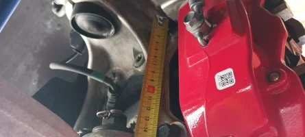

Hello. I'm not a Stinger owner, but im very interested in the OE Brembo brakes fitted to some models. I was wondering if anyone here knew what the distance was between the two mounting tabs is on the calipers (both front and back calipers)?

Will have the info shortly and some pic's for you :geek:
Hey Bud @Adrenaline
I can confirm the bracket which the brembo attaches too is 140mm from centre to centre.
Peace ✌️
Thanks so much for taking the time to do that The Real Dazzler. You are a legend.
