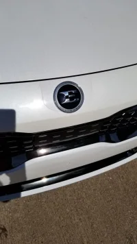

So this happened. The paint that came off was under the emblem and I had no clue until after the removal. Kinda sucks to have that right out on the front and I will touch up as best I can. 20180519_132444.webp

So tried and tried to no avail and the best option was to reclear and polish and restick the factory emblem! 2 days and no change hahaha but oh well I learned something.20180520_183943.webp

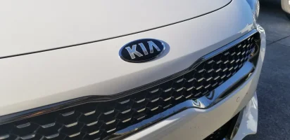

What emblem were you trying to put on? I actually had to modify my new badge to get the fit right because the holes didn’t line up. My badge was off centered using the holes.

Yeah this was a common issue a lot of us faced. I ended up having to place my round Kia Motors emblem (same as Mike's above) just a hair off-center to cover it up.
Putting the vintage kia motors badge and yes I took off one prong to center it on my bummper... I'm back to stock now and it is hardly noticable but I am sad I can't change it
