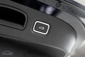

Good morning yes it has a lift button on the trunk so that’s the only way to open it. Sadly it doesn’t have an inside button like the hood one or gas tank button.

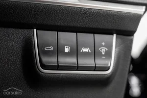

if there is no button for the hatch to the left of the steering wheel by the dash light, fuel hatch, and lane keep controls, you don't have the power liftgate.

Hi, its the second one. I wonder what I can replace the opening button with on the lift
