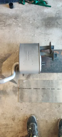

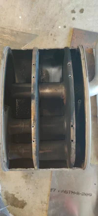

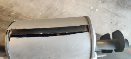

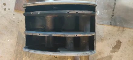

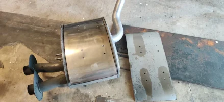

Also, cut open the factory exhaust for informations sake
I cut them open before I did the muffler delete too. I was expecting hacking it like bmw onwers does. Then I relized how straight flow is the evc side already and how quite this engine might be.
Did those factory rear mufflers have any numbers on them? Very curious to see if the Aussie MY22 has the same rear mufflers or different.
I'm guessing different because of our ADRs on noise.
right, the EVC side was very straight through. The x pipe section of the stock pipe is what I'd call glass packs or something. Inside it was just perforated piping through and then I assume fiberglass all around that, but I didn't actually cut it open I just looked in with a flashlight.

Interesting. What year is your stinger @rtv900 ?
I too cut my muffler open and it's a different design (2019).
Also mine are 2 layers, the outer shell appears aluminized not galvanized, and there's a stainless inner shell.
IMG_20200912_144945.webpIMG_20200912_150116.webpIMG_20200912_150823.webpIMG_20200912_151431.webp
wow, yeah yours sure is different.
Mine is a 22, so that would explain it.
But mine however did have the outer shell, the inner layer was stainless. I didn't realize that until I sliced around real gently and peeled it way and saw there was a whole other layer in there.
The contruction of the body looks identical, and the ribbing inside where the shell was spot welded, but they clearly changed the internals.
