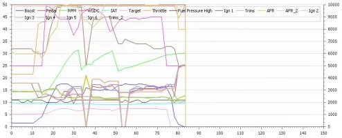

So I’ve installed. I’ve ran every log on the spectrum. Here is my take off
1)there is a feel difference, not a lot but a tad.
2)you can feel more on map 2. It’s noticeable.
3-8) I can’t tell any difference. I’m actually disappointed in 5. I am running 108 vp fuel.
this is the file on 5. It’s supposed to be the bad boy so to say with just fuel.
Just falls on its face. ‍♂️
A fail safe on the JB4 kicked in for some reason. Your map defaulted to map 0 for safety a safety reason.
You have a fuel trim variance, likely one fuel wire is installed wrong or not making connection.
