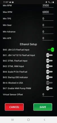

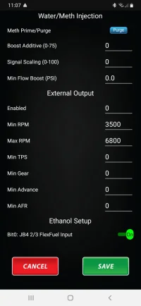

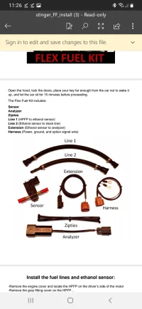

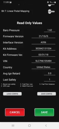

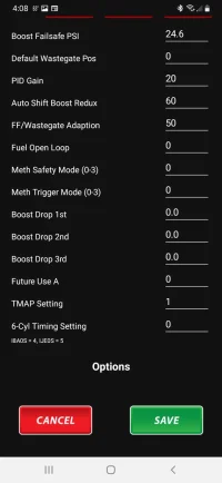

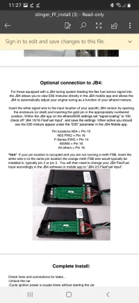

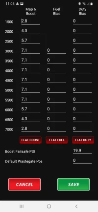

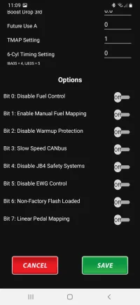

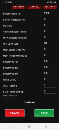

Checking with u all. Can someone look at my JB4 SETTINGS on my app and tell me if these are set up correctly for my car?
2022. MODS. Injen Intakes, Ark Catless Down Pipes, Borla Exhaust, HKS45il spark plugs, Mishimoto Intercooler, Flex Fuel Sensor kit..
Let me know your thoughts?

Did you ever get any help with your JB4 settings? Asking cause I have similar mods and will install my JB4 in a couple weeks actually.
When you send in or post a log for review it will have all your settings in it.

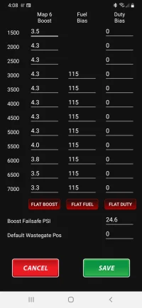

Yes I will post a screen shot of my current setting next time I jump in the car. Today i dropped some E85 in there and I ran a bit on Map3 with the E30 blend. Car so far is liking the settings. I still need to send my logs off to be checked.
