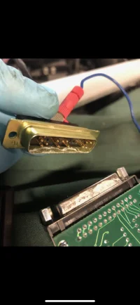

Hey for some reason it doesn’t want to connect or turn on. Power and ground is for sure good I see it’s used and found this water looks like it was sitting in it but everything is for sure right on this end tested power and ground.
Need help!!!

Photo of front and back of JB4 control board?
It's at the shop right now I'm trying to get a hold of the tech to get pictures.
No water damage but I see the FSB pins are not inserted, replied to your email.
