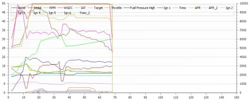

First post here. 2020 GT2 feels great on Map1-3 but when I logged map3 my IGN numbers are bizarre. 2-6 mostly read zero, then read all over the place. Running 93 octane plus Lukoil octane booster (not the best but I figured I'd get 1-1.5 octane out of it). Thoughts @Terry@BMS ? Map3 WOT attached.
Still learning how to interpret logs so any caveats would be welcomed.
EWG wires, bms intakes, intercooler upgrade, HKS plugs gapped to .022.

According to your log it's not wot pedal would show 100.
Pedal column shows 100, throttle is at 99. I assure you it was pedal to the metal. I didn't know about auto logging so I manually logged at a stop light right before I merged into the highway. It's like a 40 second log, just gotta, you know, read the log... 0.o
Pedal column shows 100, throttle is at 99. I assure you it was pedal to the metal. Not sure if that's another symptom that something is off electronically. I looked at 4 logs with 7 instances of pedal 100... Throttle never exceeds 99.
Ok see it now just didn't scroll down far enough.
As far as timing it's normal. In Map3 pushing almost 20 psi you can expect some knock. Cylinder 6 is the highest at 3 deg during high boost but still OK. I would suggest an E30 mix instead of octane boost, and pulling that plug to check gap and torque.
My biggest concern is the huge variance between Trim 1 and Trim 2. It looks like one of the fuel wires isn't making a good connection. Because the sides are agnostic, I can't tell you which one is which, so check both really good.
