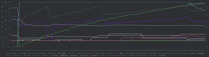

Map 3 has a good pull from about 30-115mph in rows 117-197. Here's what it looks like in Datazap:
- Green line (leftmost axis) is speed, Blue line (next leftmost axis) is pedal, Grey line (third leftmost axis) is rpm, making shifts obvious (important for ign/timing advance)
- The rest of lines are on the right axis. Purple is the ign_1 column, or absolute timing advance, which you want to see building with revs, and sudden drops >3 degrees indicate timing being pulled due to knock. Your only drops are at shift points which is expected. So far so good.
- The lines at the bottom are ign_2-6, which are cylinder 2-6 timing retard relative to cyl1, and again it's the 3+ values we care about. Your file has a bunch of 0.8 and 1.5s which we can ignore, but if you look at the part just after your second shift (rows 160-175 in the file), you have a handful of 5.3s in ign4, and then some 3.8s in ign6.
So you could be hitting octane limits. Might be worth increasing e85 to 5 or 6 gallons/tank instead of 4. You don't need to empty your tank to do this, just add about 1.25-1.5gal per quarter tank (so 2.5-3gal if you're half full, etc) with the rest 93, then do another good pull. Or hop on the BMS forums and see what they think.
