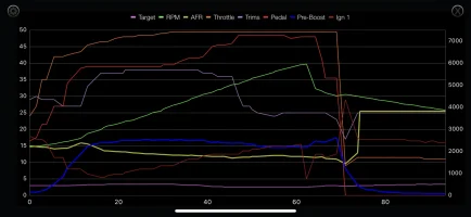

Map 1 (10-80 mph) full throttle hows it look? Ready for e30 and map 2? Thanks
little bit of timing deviation. I wouldn't go past map 1 unless you go e30 or have access to 93 octane.
Must be running 91 octane right now, correct? did you do the plugs? any other mods?
Im running 93 with a bottle of seafoam and have densos 47s no other mods besides occ and bovs

hmm, run the seafoam out and put in a fresh tank of 93 octane and do a map 1 again. I'm sure others will chime in as well. It may be worth resetting the ECU as well, just to get a fresh start.

Will do thanks for the help!!
