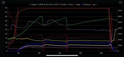

Post csv log
Your boost does seem really low, and you are getting timing pulled where it shouldent be. Im thinking bad gas. What did you put in it? 91? 93? I would drain it as low as possible and go to a different station and try their premium. maybe some 87 got put in the wrong tank when the station last got filled.Let me know if those work, if not I have others! Thanks guys
I been putting 93 in it, when I first got it from the dealership it was very sluggish so I drove all the gas out and then started putting only 93 since. That helped it a bit but I know its nowhere where it should be. I did buy it used and it came with everything in the "450 hp" BMS/JB4 package. Im also changing the plugs soon just incase. Other than that im out of ideas.Your boost does seem really low, and you are getting timing pulled where it shouldent be. Im thinking bad gas. What did you put in it? 91? 93? I would drain it as low as possible and go to a different station and try their premium. maybe some 87 got put in the wrong tank when the station last got filled.

Should I post a map0 pull?Its def worth a shot, if it doesnt fix it, take the JB4 off the car and see if you still get really really low boost stock. if so, take it to the dealer and tell them to fix it under warranty cuz they sold you a car with an issue.
you can if you want but it may still have super low boost. really you should post some under the hood pics to see if we can see any basic stuff that may be causing it.Should I post a map0 pull?
Gotcha! i'll take some detailed pictures later today.you can if you want but it may still have super low boost. really you should post some under the hood pics to see if we can see any basic stuff that may be causing it.
YesShould I post a map0 pull?
