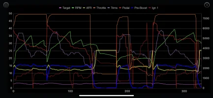

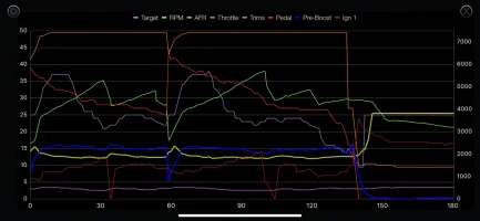

I wanted to chime in this discussion just got my JB4 installed did some logs and wanted to post them and ask if everything seems good? Please if anybody can advise if something is wrong. I have 2022 stinger 3.3 AWD no mods other then plugs and Jb4.
Those aren't logs, those are jpg's. You need to post the csv file. In addition, you weren't 100% pedal in any of those. You need to go WOT either from a dig through a few gears, a 3rd or 4th gear pull, or a roll from 40ish to whatever your road can handle safely.
