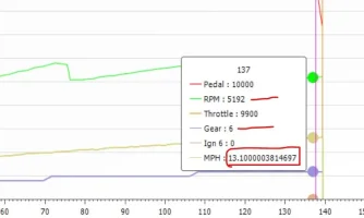

The JB has no control over the transmission. I think you have something else going on. You can floor it and get well over 130 mph in 6th gear before the transmission changes to 7th. 90-100 you would be in 4th gear, not 7th. I attached a screen shot of a log I did this morning. At 131 mph, I was in 6th gear and only 5192 RPM. I'm not sure what's going on but I think you're in a different gear than you are. My 4th gear went from 88mph to 100mph before going to 5th and I paddle shifted early.gear.webp
