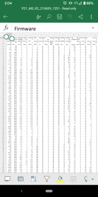

Let’s see some log.
This was back to back runs from same spot. stock vs map2Screenshot_20210609-115941~2.webp

Need csv file

If you need tech support you'd email support@burgertuning.com. Beyond that there is no log posted here so can't help much with what you have so far. You'd have to attach the CSV log to the post. Photos of the CSV doesn't do anything for us. :)
