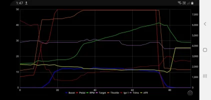

This is my map 0 I did pull today. Will most likely wait for plugs before I do anymore maps
Looks normal to me

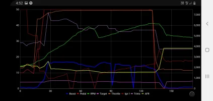

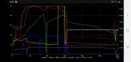

Ok finally got it solved just download the beta and seems to work good now I got 2 maps if you could see if map2 is algood and if map 5 is ok aswell cheersScreenshot_20200518-165245_JB4 Mobile.webp Screenshot_20200518-165239_JB4 Mobile.webp
