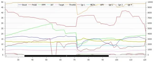

So we here is SWFL received over 14" of the wet stuff in the last 3 days. Gave me a chance to install the HKS M45 plugs and run the JB4 on my 2018 GT2. So I've read at nauseum to all things applicable to these JB4 units. I have AEM intakes, Velossa Tech Snorkels, and OCC. I'm going to attach my 1st log. I only had a little time on the road to get a 3rd gear launch and did the best I could. Loosing some traction. I just need some kind soul to see from the results if there is anything silly I should be aware of. I'll do a proper one when I can on the much crowded I75 and post back when I can. TYIA.-Josh

What fuel are you using?
None of the log is at WOT.
It was floored but showing 99 percent? Again it was the best I can do. I have others, but seems like I got through the gears pretty good. I can't make it to the track yet too far. Still trying maybe this weekend will see. Thanks for the reply.-Josh
I always put about 4.7 gall of E85 and the rest 93 when I was trying to run E30 and didn’t have a fuel-it sensor. With that I could easily run MAP3 with 0 issues. As Darrin said try to get a run in at WOT and log it. Mash that pedal all the way to floor and don’t let up :)
The top red line is your pedal. It started at 99 but for a split second, then between 50 and 70.
