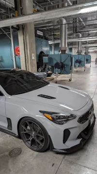

Hey guys. A buddy was helping me take off my snow tires and foolishly didn't jack up the car properly. I shouldn't have assumed he knew what he was doing. So anyway I have some bent plastic. I was thinking about some sort of side skirts to hide it but I'm up for suggestions please.
Thanks guys!

We've seen worse. In the pictures it looks more discolored than deformed. At least you don't appear to have pinches.
True I guess. I might add a skirt and see if I like it. If I do ill post. They seem to go on and off easily
I have skirts that most likely will affect it sitting flush against the car in that area PXL_20231221_232803051.MP.webp
I would pull the plastic rocker panel off it just snaps on and see if you can correct the medal under it and maybe use a heat gun carefully on the rocker panel to remove the crease or reshape it
Do you know if it's better to pull off from the front or back? I wonder if the metal underneath is even dented. Seems like it might just be the plastic. Guess I'll find out if I can get the rocker panel off. Thanks!
I only know that it snaps in place under the car that was loose on mine causing wind noise in the B door pillor.

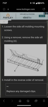

The link is for a Optima has to be some what simular still a kia
This pic is from Screenshot_20240329-190713.webpKia Stinger service manual
Awesome video. I'm sure the stinger panel comes off the same way. Thanks!
