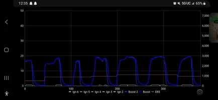

This is what I see on my app. The boosts are just going in and out, so I think that might be why its kicking.
I understand, that's why I was asking if this was a consistent thing or you just noticed it that one time.
There are a lot of factors here, do you have the flex fuel sensor for ethanol? Otherwise you can ignore that e85 reading.
Also, I can't really tell but if this is a screenshot of the log you linked earlier, I believe it is just showing the boost when you step on the pedal. Throughout the log you get on the pedal and come off, and I think thats just showing on vs off the pedal. Nothing necessarily related to a boost leak or cut.

The is no code on the jb4. Also I think it's only at 15 because it's still missing. I'm not sure how fast it mixes. But it's still steadily climbing since this
I also don't remember letting off the pedal.. Could it be cutting out?

You're crashing your fuel pump, guaranteed. Don't look at the JB E85 reading, it means nothing and isn't near accurate. Put some more 93 in it and it will more than likely clear up.
If you want an absolute answer, please post the csv log of it happening at WOT.
If you never let off the pedal in that log then it is probably the fuel pump. Basically everything @AWDGT2 said.
