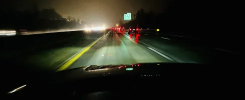

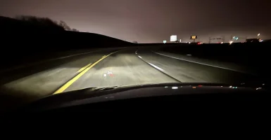

I’ve been looking at pictures and watching videos to compare, but can’t get a definitive answer…
This morning is the first time driving the car in the dark since buying. Is this headlight projection normal? It seems as if one side is higher or lower, or maybe one is way out of horizontal alignment?
TIA!

left headlight shines very low, right headlight shines far to the left. You have to set it up / have it set up
Ar
Are you saying that’s the norm?
If that’s the case, it looks like what I’m seeing.

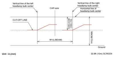

Park your car about 30ft from a blank wall and check headlight aim & pattern. I usually just use my long driveway and garage door. It should look something like this:
It is normal for the outside/right headlamp to be aimed a bit higher and to the outside/right than the inside/left headlamp. Yours is extreme, low and high.

nope.. definitely needs adjustment. Easy to do on your own with a long screw driver..
Yours is way off. Needs adjustment.
Very off…lol
Can they be adjusted horizontally?
