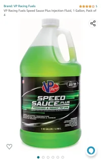

Im currently on lap3 stage 1.5 using the jb4 as the meth controller. Right now im using boost juice 50/50 mix and its running good as im on my last bottle and was curious if the 80/20 mix from VP Racing will give me a bit more power due to octane? Is it still safe and not as flammable since its not 100% meth?

call around to speed shops in your area and see if you can buy the 5 gallon pails of VPs m1 methanol and just mix your own with distilled water, much cheaper.. the hires in my area has a speed shop and they sell them there!
I'm wondering too, so I will watch this thread to see if anyone actually answers the questions instead of offering alternatives.
Power no! Top end speed maybe a tiny bit! Is it flammable yes, is 50/50 safer yes! Even moonshine lights on fire and thats 50/50. Try it and see but i doubt it will be noticeable as ive ran 50/50 60/40 and 80/20 and it all feels the same
