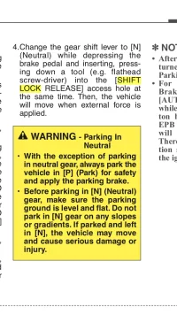

P P-Man Newish Member Joined Jun 19, 2019 Messages 8 Reaction score 3 Points 3 Aug 8, 2019 #1 Hi all, Am I missing a small piece of plastic near my shifter? See circled section in the attached photo. If so, where can I get a replacement part? Thanks. P Attachments 01545D3C-7ABD-4E78-8AE4-1CE3A0B4AFDC.webp 71.2 KB · Views: 52
nhcowboy28 2500 Posts Club! Joined Oct 30, 2018 Messages 3,500 Reaction score 2,697 Points 118 Location None of your damn business Aug 8, 2019 #2 Yes. It’s the cover you need to remove and push a button (or your key) to shift into neutral when your battery is dead. If it was missing from the start, go to the dealer.
P P-Man Newish Member Joined Jun 19, 2019 Messages 8 Reaction score 3 Points 3 Aug 8, 2019 #4 Thanks. Is that the Shift Lock Release cover? ______________________________
MerlintheMad 10000 Posts Club! Joined Jun 2, 2018 Messages 18,799 Reaction score 7,063 Points 118 Location West Jordan, Y00TAW Aug 8, 2019 #4 P-Man said: Thanks. Is that the Shift Lock Release cover? Click to expand... It is.
nhcowboy28 2500 Posts Club! Joined Oct 30, 2018 Messages 3,500 Reaction score 2,697 Points 118 Location None of your damn business Aug 8, 2019 #5 P-Man said: Thanks. Is that the Shift Lock Release cover? Click to expand... Yes
