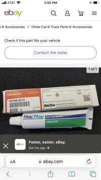

Sounds like dry door seals. I had the same issue. Order some of this and apply it to all the seals around the door jams, hatch and sunroof. I apply it twice a year, once on the spring and once in the fall and my cars quiet. Hope this helps…5366755F-00CC-4D42-8EE8-C1C24CC8D611.webp
^^^I’m 99.99% sure that’s your issue. It’s pretty common.
Sounds like dry door seals. I had the same issue. Order some of this and apply it to all the seals around the door jams, hatch and sunroof. I apply it twice a year, once on the spring and once in the fall and my cars quiet. Hope this helps…View attachment 71924
Thank you! Will order now
For sure! 1 tube will last a very long time. Apply sparingly and rub it into the seals. A little goes a long way. You’ll feel the seals get nice and soft and you should be good to go
Ahhhh yeah I didn't even think about the dry seals. That's very possible as well!
I bet that a spray can of silicone onto a rag would accomplish the same thing as from a tube.
Maybe for a short time...
But Shin Etsu grease is widely known as the absolute best for this application.
Can’t speak to that….only what’s worked for me personally.

Dielectric grease does wonders and it might be the same stuff as the ShinEtsu above....but more easily found.
DEF: Silicone grease, sometimes called dielectric grease, is a waterproof grease made by combining a silicone oil with a thickener. Most commonly, the silicone oil is polydimethylsiloxane (PDMS) and the thickener is amorphous fumed silica.
