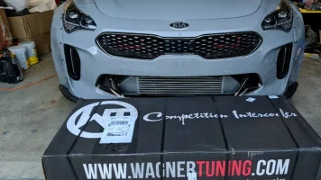

After recently installing the BMS intercooler it appears that most of the extra cooling surface area that was achieved by upgrading from stock is being blocked by the plastic bumper. Is there a solution for that? I'm sure someone else has had this thought too?
You can cut some holes in the bumper. Some people do it. Never seen it on stinger through.IMG_0206.webp
Like this?
Speed Holes!
Hmm, thanks for the replies. I didn't want to do any cutting. Will have to see how creative I can get.
Are you talking about the height or the width? As for the height, the bumper is irrelevant as the cash bar is the real blockade. And I hope no one is about to go cut holes in the front crash bar... For the width you can always get a Dremel and cut out the fake vents on the lower grill. When properly done it is actually very hard to spot. That adds about 2 extra inches on both sides of airflow
Thanks for the responses everyone!
Same thing with the 3d snorkels on the main front grille . Dremel out the corners and you are good to go
