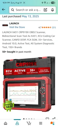

Thanks that is great information. I have purchased keys and a body unit apparently from the same vehicle. I shall use those and hope I haven’t been misled by the seller. Could you recommend a good bidirectional scanner?
This is the one I got, it has all the bells and whistles but you'll have to play with it and watch YouTube to figure it all out. My son has the bluedriver, I hear it's good but I've never used it so I don't know anything about it. Launch is a good brand.
