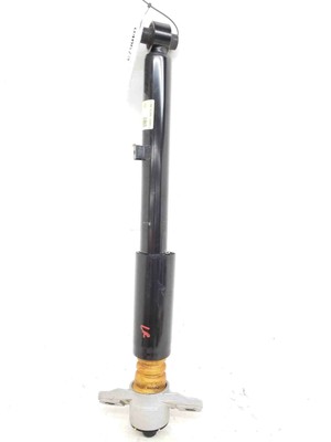

Not sure how badly you want it but here is a lightly used rear shock with the part you need clearly in the photo:
2018-2020-KIA-STINGER-A-REAR-STRUT-SHOCK-ABSORBER-55300-J5400-OEM-2019/
This is the "mount" I was looking for!!! Thanks. Racing at Shenendoah in two weeks I hope )

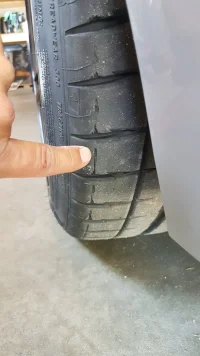

The Ark DTP. Its not rubbing on the street but it did on the track.
