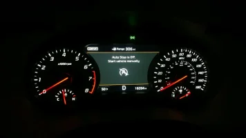

My car just shut down while ISG was not disengaged. Once it shut down, the dash emitted a loud beep and instructed me to start the car manually, that Start/Stop was not functioning correctly. The amber A is constantly blinking now. I've tried restarting the car normally but the issue returns

Took it to the dealership. First visit they could not duplicate the problem or register any error codes. Today, no error lights, but it felt like I was neutral-dropping the transmission every time the engine restarted.
Long story short, today they were able to replicate the problem and register an error code related to the electric oil pump that feeds the transmission. There aren't many cases of this yet, apparently, so they're going to research it on their end and have me come back to repair/replace/reprogram as necessary.
The service tech was guessing that the pump may be necessary to maintain fluid pressure in the transmission when the engine is offline and perhaps it's failing/offline which is causing the huge jerk/bang when the engine restarts. I'll be keeping ISG off for now until this gets resolved.

**UPDATE** 01/18/2020
The Stinger has been at the dealership for over a week. They contacted Kia NA and were advised to replace the transmission oil pump.
That did not resolve the issue.
Kia NA instructed them to then replace an inverter assembly and we're waiting on that part to arrive and be installed on Monday.
Stay tuned....

***UPDATE 01/23/2020***
Got my car back last night. Issue has been resolved.
The latest item to have been replaced was an inverter assembly. So, in all, two items were replaced: electric pump assembly and inverter assembly.
So far, the ISG feature seems to respond as designed.
