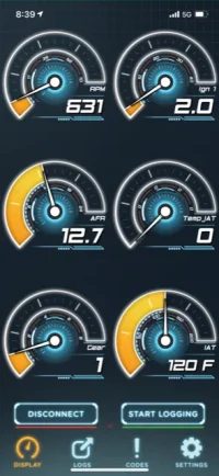

My IAT gauge is not measuring. All other gauges are reading fine. Anyone know why this only gauge is not reading?

No unfortunately it did not. I reconnected the connectors for the IAT. But then I realized that I have IAT reading, however I do not have Temp_IAT reading. I use to have a gauge that told me what map I was on. How do I change what gauges I can choose to monitor? Thx
It should be the IAT one. You hold the gauge to change them.
me and my brother had the same problem at the same time yesterday. We are both on the beta firmware. We unchecked it and rechecked it in the view mode and it eventually went from 0 to an actual # with a large delay. Never had issues with it before.
