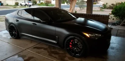

I'm using 20x10.5 Rear 20x9 Front Vertini wheels with Nitto NT555 G2 (285/30/20 + 245/35/20)
Car is lowered on Eibach springs and I think the rears are at their max width for stock fender flares. Lots of traction with this setup.
I've got the exact set up (copy cat! :p) but I believe he can/should go a little wider in the front, unless he wants a 245 square setup.
What offsets are you running?
