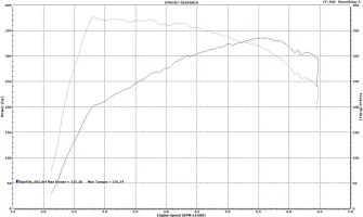

was 340 your baseline whp?
Yes. But I read somewhere they use STD correction instead of SAE. So figure their stock numbers to be closer to 315ish.
Here is our stock dyno run with SAE corrections.
