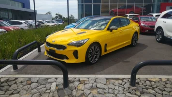

Looks great, the clear bra is the way to go, as im personally done with the hard plastic protectors, and i have also had one of those front car bras, both a thing of the past, for me anyway, 2 weeks ago when i visited my local dealership, the service guys were applying a clear bra like this on their showroom Sunset Yellow Stinger, and now outside in the yard, this is the same Stinger, and i tried to check about Ozstung's heater pipe issue yesterday.
