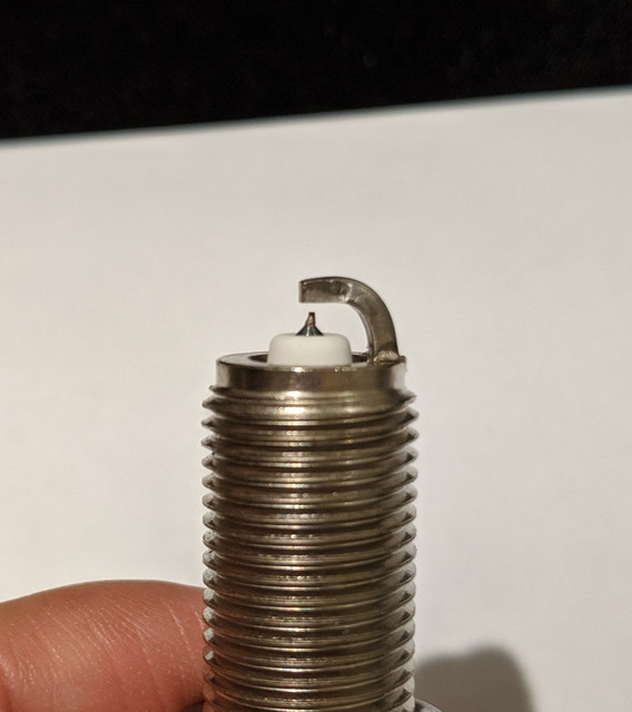

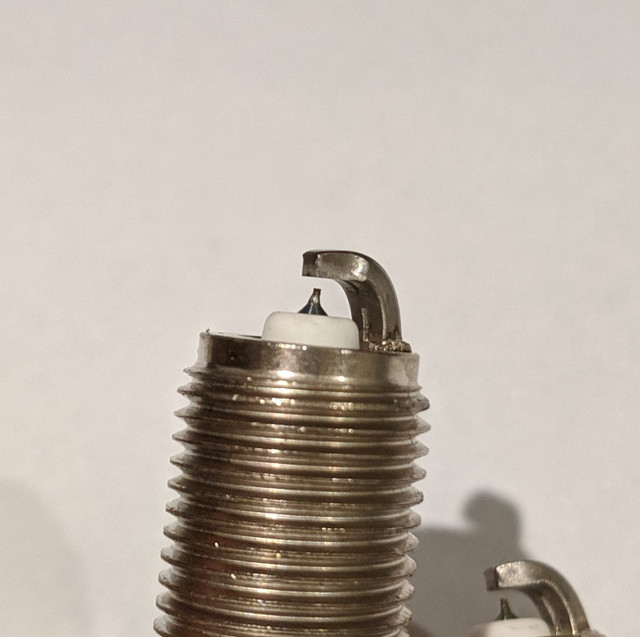

I think the Densos have some questionable quality. I bought a set from BMS, and while I'm sure these would have worked in my car "fine", I still didn't feel comfortable installing these four out of the 6. I wish I had inspected them before gapping them, but it wasn't UNTIL I was gapping them that I noticed some crooked electrode tips and some inconsistent welding around them. One even had a tiny little spur sticking off of it!
BMS denied any returns and said that they've sold plenty of these, so apparently that means my set isn't a problem. I ate the $60+shipping and just tossed all of them.

Nice try: I use the same gapping tool you sell. The electrode tip is never touched. Like most, I didn't actually look at or near the tip until I'm looking at the gap, and that's when I noticed four of the six I bought from you all looked like this. I took pictures, and sent them to you all, and you all just gave me the proverbial middle finger acting as if because there are thousands that are fine, these are fine to put in my car.

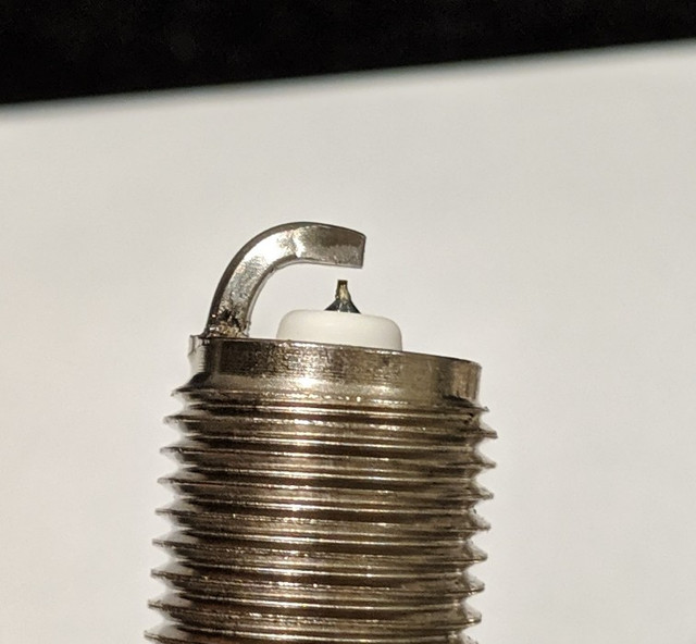

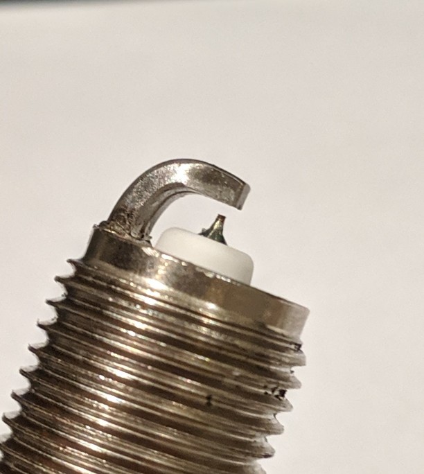

Sure, I only ate $60+shipping, but that kind of customer service terrifies me. I am more than sure I made the right call to toss these. Besides, you can tell from these pics that the tip was never touched. If it was, you'd see evidence of cracking or bending. These are just poor quality spark plugs that have their tips welded off center and crooked, and in once case, that tiny little spur coming off the weld (which can become a problematic spark point under heavy heat/loads). Only two of the six I bought had perfectly centered/straight tips.
Most of the ones I've seen are straight tips but if that is how you received them from us then that is how Denso sells them. Rarely do we have any issues reported with them but a spur would certainly be cause for concern and need to be removed. Our support guys aren't going to know much about plugs as we're just reselling them and once they've been gapped we generally can't take them back for obvious reasons. Sorry you felt you had to eat 4 plugs, we can always do a store credit for you next time you need something.
