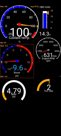

Weather was -5°C
But idle rpm when engine fully warm (100°C) was 631 in neutral, and the exact same in drive.
Sceenshot from just now.
