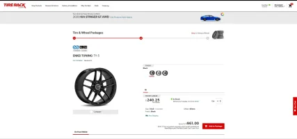

You cannot go wrong with Enkei's flow-formed MAT wheels. We have 4 sets of them. The closest to the TY-5 18x8 ET40 you are considering is our RPF1 18x8.5 ET40. I bought them from a guy that had them on a WRX. Of all our Enkei wheels, RPF1 had the tightest clearance to the Brembos. Mostly because it's a racing wheel that is shaped for maximum weight reduction. Still, the RPF1 cleared the front Brembos no problem.
If you are considering the TY-5 18x8 ET40, you might seriously consider spending $10-15 more per wheel and get 18x8.5 ET35 instead. For winter tire duty, either will work just fine with 235/45R18. But... 18x8.5 gives you the option of mounting up to 255 width tires, in case you ever want to put performance Summer or A/S tires on them later on. If this was my money, I'd want that flexibility.
BTW, when buying aftermarket wheels, I highly recommend you choose a wheel that is very popular. I understand it's nice to pick one that is unique and allows you to customize your ride. However, if that wheel has to be special ordered from the mfr, not only does that take additional wait time, it also runs the risk of the mfr deciding at some point to discontinue that style, because not many buyers choose it. Then you are up poop creek if you need to buy a single replacement wheel.

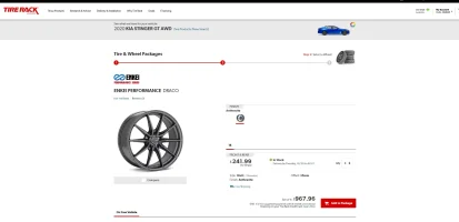

I'm honestly starting to really like the ENKEI Performance DRACO 18x8 35mm. I don't think I would ever put Summer tires back onto these wheels they would be strictly for the winter so I think 225 would be best for me. I saw someone that has the DRACO same exact how I would do 18x8 35 with 225/45/R18 on a G70 so I assume it would work perfectly well for the Stinger.

Not all Enkei wheels are flow-formed. The Draco, and I think their whole Performance series, is not MAT. It's up to you, but I would only consider flow-formed, for the strength, durability and lightweight.
Even for dedicated winter duty, good quality flow-formed wheels only cost a little bit extra and are well worth it. Would definitely be easier to re-sell, if that becomes necessary.
