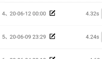

Did a test last night with a Vbox and the results are on the picture. I'm running premium gas by European standards (98 not cheaper 95)106130687_1200273400308304_6976674644182972874_n.jpg

Did a test last night with a Vbox and the results are on the picture. I'm running premium gas by European standards (98 not cheaper 95)View attachment 47132
Is your Vbox set to subtract out the 1-foot rollout distance? Published 0-60 mph (or 0-100 kph) times subtract out the time from a stop to 1-foot of travel. This 1-foot of rollout can be up to 0.3 seconds.
