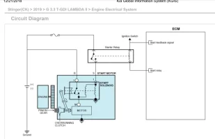

Hi,
My Stinger's starter is stuck (always on, won't stop) and I had to disconnect the battery to stop it. I pulled the start relay from the fusebox in the engine compartment and the starter still won't stop turning, so probably the starter solenoid is stuck.
I need to tow the car but the electronic parking brake is still on and the transmission is in Park (well, at least that's how I remember it before I disconnected the battery).

If you have removed the correct starter relay, how is the starter getting power?
EDIT
as @JSolo pointed out, a shorted starter solenoid can cause this situation even with the starter relay removed

It could be that the starter side of the relay is shorted out (contacts are
not opening). In any event pulling the starter relay out should work.
^^If the starter solenoid itself is somehow shorted internally, then it won't matter if the starter relay is present or not. That is, the high power side of the solenoid is maintaining a closed circuit all on its own.
