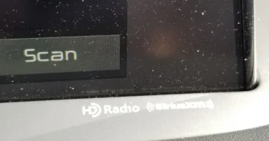

Does your screen have "HD Radio/SiriusXM" printed on the outer rim/bezel?
Okay just went to the car and confirmed.

and here is the HD marking on the bezel:
Hope this answers the questions. I have a GT2 AWD model.
Damn is is dusty in up close pictures sorry about that but wanted to get something up to show you it was there.
-Fal
Damn...my base GT doesn't have HD Radio then. It doesn't say it on the bezel.
