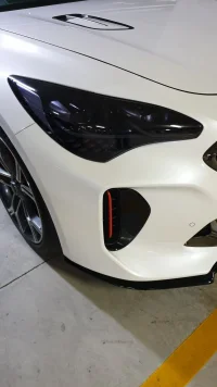

Stek tinted PPF. Not precut like Laminx so a ferfect fit can be achieved. Housing is dark so film appears a lot darker than what it actually is. Very little loss of light and I believe well within 15% limit allowed here.
View attachment 59725View attachment 59726
Have you noticed much or any reduction of light from the headlights when driving at night.
I don't do much night driving so hard to compare but I think any loss is minimal.
