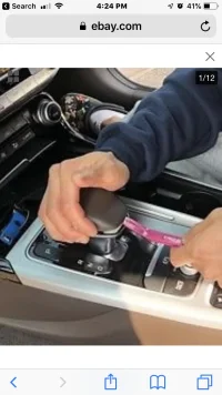

95AE02C5-DBB6-45CE-9C01-8558E5476997.webp 08AC9EB8-25EA-429A-AD71-CDF930D6671E.webp I’ve only seen the Alcantera swap.
You use a trim tool to push between the leather and base Facing the rear. It wil pup up, then you pull towards the front. You then have to replace a bottom section. First removing the “button”... a bit tricky. Flat screw driver in a few pressure plate holes. Then a few screws.
Not too bad.

Do you have pictures of the next steps of this, by any chance? The top part is super easy, but the button is really tricky. I can't find any schematics, so it's tough to tell where to press without damaging the actuator.
I assume the tabs actually connect to the button, and you have to lift the tabs up out of the actuator...?

No schematics.
You basically wedge a small flat blade screwdriver into the openings on the buttton actuator box (sides) to release the button. Then the other side to release the box itself if I recall.
I’m not that smart and did it without breaking anything. You got it.
Any chance of a photo? Somehow I’m not getting the button to pop out. I’ve used a small flat tip screwdriver but no luck.
No photo. But on the inside black housing, there are a few rectangular squares. Fiddle tour screwdriver in those. Eventually they’ll release the button. It was 10 months ago so I barely recall. It wasn’t hard. Use your phone to take pics in there to see better.
