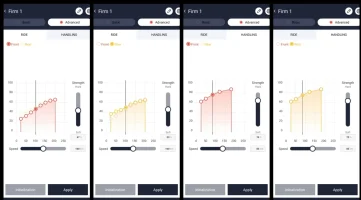

mando suspension tuning module, though most settings seem too stiff for the car to be happy sliding. i find turning the mando off
is the smoothest most of the time.
I see people like “TireRipper” on youtube and his car slides perfectly, i don’t see any wheel hop. I know the adaptive suspension is different, but what would be the fix to this? bushings?
What settings have you tried?
I find less hop/chatter with some firmer settings.

Many. My sport springs change the rebound quite a bit but i’ve tired both advanced and basic settings ranging from the stock sport all the way to using 80/85 stiffness, and i find that the wheel hop is a lot less prevalent when I use the stock setting. When I used a stiffer mode, it really felt like something was just banging up and down but stiffer. I haven’t tried enough settings for spinning, but so far stiff did not work out well. I’m starting to think I just need to raise my tire pressure, especially with slightly oversized tires. the sidewall flex or just not enough air could be causing me to lose and gain traction. I don’t remember having this issue on stock tires. There’s also a possibility I’m just not keeping RPM high enough to keep spinning well.

Really, it's kind of mood dependent!
My current preferred "firm" settings are
