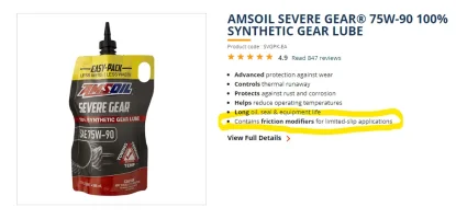

I don't see anything marketed for LSD in severe gear product. Although I see they have additive for LSD. Which has this note:
NOTE: AMSOIL synthetic gear lubes do not require this additive. However, not all differentials respond the same and the addition of AMSOIL Slip Lock will eliminate chatter in mechanically sound differentials.
Did you use any additives with ASMOIL severe gear or does it have enough additives itself for stinger?

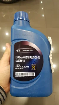

The OEM LSD fluid for Stinger
Got the following image from internet.
But the Amsoil is just as good, if not better.
