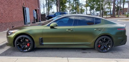

Hi everyone
I have a 2019 gt rear wheel drive , stock 19 inch wheels, I do spirited driving and some hpde
I'm thinking about getting the gecko race coilovers to lower the car about 1.5 to 2 inches with the front camber plates and also the Megan racing front trailing arms and the Megan racing rear trailing arms and rear camber arms.
Does this seem like a good combination to lower the car correctly and keep the tires in proper alignment?
Any other suggestions are appreciated.
Thanks
