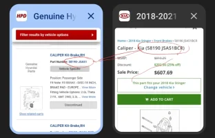

So Ive been highly considering doing the brake upgrade to the Brembos, since the 2.slows did not come with them.
With that said, will the G70 Brembos fit?
Or should i just stick to the Stinger sets?
I can’t see how they’d be different, other than making sure the fronts match your drivetrain (ie if you have AWD, the donor g70 should be AWD too.) Other than the driveshaft difference they should be the same. These two cars share many components.
Kind of my train of thought on it too.
I just dont want to get "stuck" with a set of calipers for some dumb reason. Then i gotta try and sell them.
The fronts do not have to match the drivetrain.
The Brembo brakes are the same for the RWD and AWD
So im good if i go with the g70 Brembos?
They even share the same part numbers.
Thanks for that! Much appreciated
Might want to make sure your brake lines are compatible before pulling the trigger.
There's a good chance they are but during the swap is a bad time to find out they're not.
