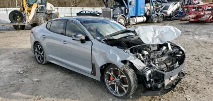

I don't think that is true. reason being, when a gt1 or a gt2 is purchased, you automatically get the upgraded stereo package which includes a lot of the info that gets processed through the cluster. nav, stereo, etc. so even if you get the cluster, certain things wouldn't work, like was posted above. so why do it then? I had already inquired about updating the stereo in mine, and the service department manager said it wasn't worth the effort to do it because even though would have the upgraded stereo, I couldn't use half the performance stuff. I guess I will have to buy a rear ended gt2 and a head on wrecked gt and do some surgery to both. franken-stinger. muahahahahahahaahahahahaa
