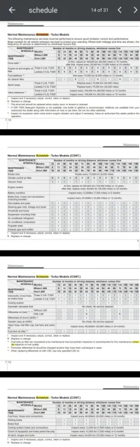

Why did you do a fuel injector flush? It's not a service listed in the manual
Transmission fluid flush, I recommend you do nothing, unless there is something wrong.
Have you read the owner manual? Specifically the maintenance schedule?
What year and model are we talking about?
AWD?
LSD?
I guess those prices are fine, but why did you need either service? Was your alignment out? Did your tire wear indicate your alignment was out?
Or were the techs just hungry and you didn't need either service?

That's funny. The service tech told me that was listed as a 60K recommended service. I bought the vehicle used and didn't come with an owners manual. Will have to order one.
It's a 2018 AWD GT2.
The alignment showed being slightly off when they put it up. He said if it didn't need to be re-aligned he wouldn't charge me. *see attached. Top is before bottom is after.
Also said that there were no adjustments on the vehicle for him to adjust the rear. Is this true?

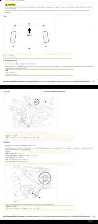

Rear toe and rear camber are both adjustable....
See attached
Might want to go back and have them correct the alignment or return your money they "stole"
And ask them what they are smoking for leading you into a waste of $$$ injector cleaning.
They must be hungry or something.

The OM is available online as a PDF for free ;-) Unless you really want a paper copy

Wow, thank you for that. Ya, I was really surprised when they told me this.
