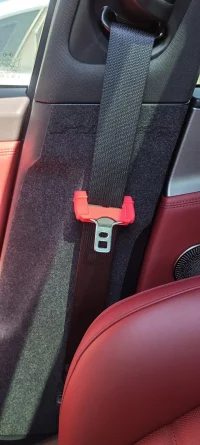

Fit one of these, solved the issue you described for me.

So, the silicone seatbelt covers are not all that good. Yes it does keep the buckle from making noise, but the silicone also causes the buckle assembly to hang up on the belt, so you have to feed the belt through when you retract it.
I ordered the B pillar felt protection panels from Shark Racing. Ordered on Sunday, Got them today. Lightning fast shipping. They fit great, and it really seems to help the buckle noise.
Moin moin (I know it is evening) ok, I will have to play around with it then. I may just remove it. Danke for the photo.
Yeah, when I installed it like the photo you posted, it works much better. Thanks again
